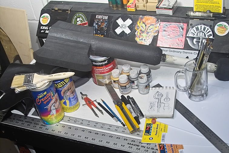

You will need to begin this oredeal:
brilliant ideas
At least one safe, legal Dagorhir weapon (hint: if you can't do this yet, you might want to practice a bit before tackling this)
Rulers/straight edges/french curves/compasses
paper and pencils
razor sharp knives appropriately sized to the project
leather punches
fun foam of varying thicknesses
DAP
disposable chip brushes
black plastidip
paint for these I am using Liquitex Med viscosity acrylics
paint brushes also appropriately sized for the job
clear plastidip nope it ain't too good, how 'bout a quality spray varnish like Krylon cryastal clear or thinned down "through the roof" roof sealer
cloth for the cover
material for the handle in this case I'm using black garment cowhide

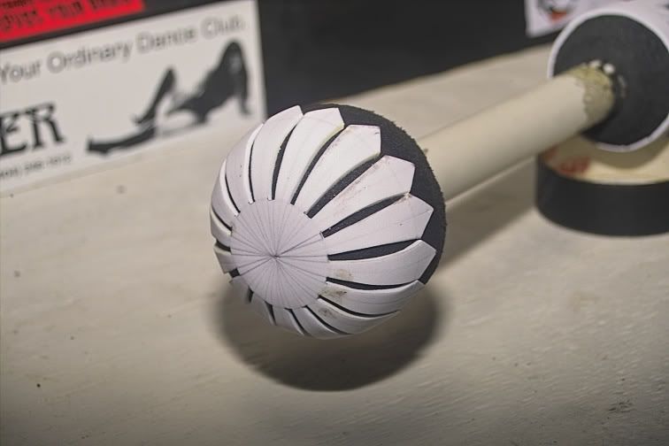

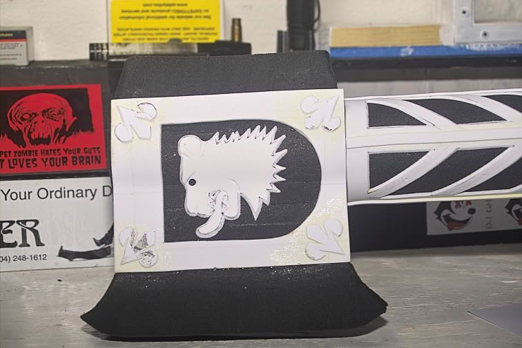

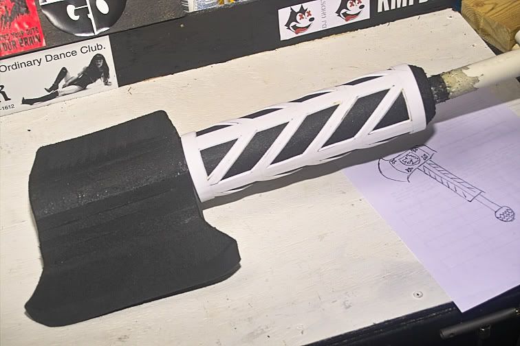

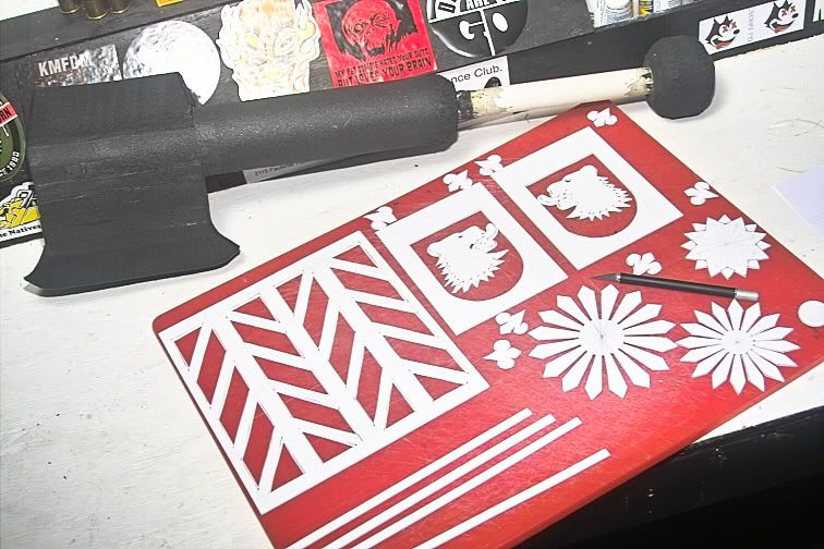

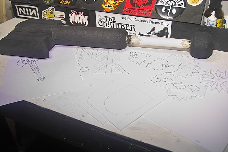

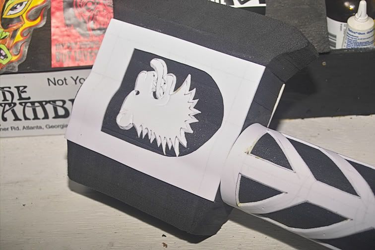

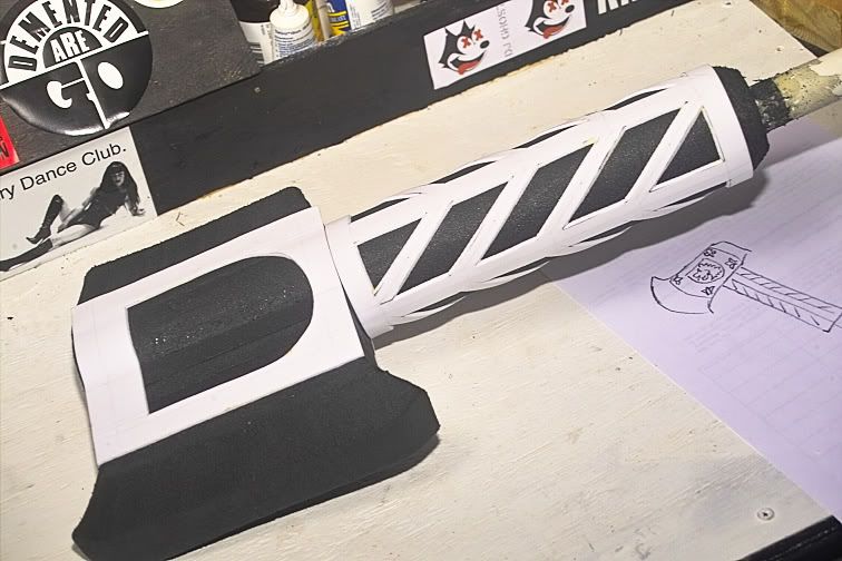

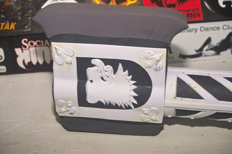

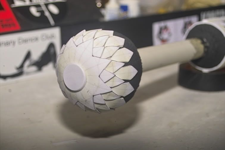

Sketch out all of the decorative fiddly bits you want to stick on your weapon.
Draw them on to the foam.  I have been able to track down 2mm, 3mm, and 6mm funfoam.
This allows a great deal of flexability when working the depth of the designs.
This particular axe I was going for a kinda heraldric knighty good guy thingie.  Mostly 'cause Athron was fussin' that good guys never have any sweet looking gear.
I used 3mm for the critter head and 2mm for everything else.

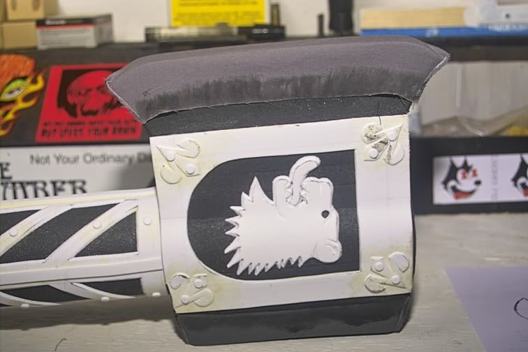

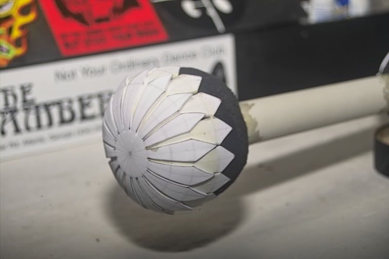

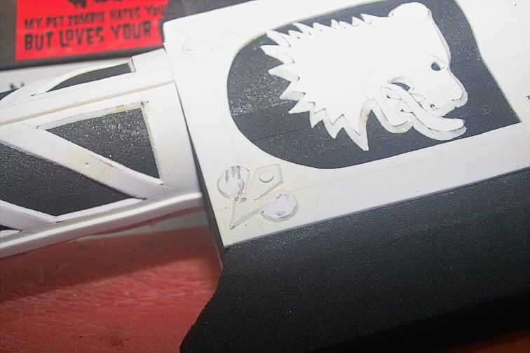

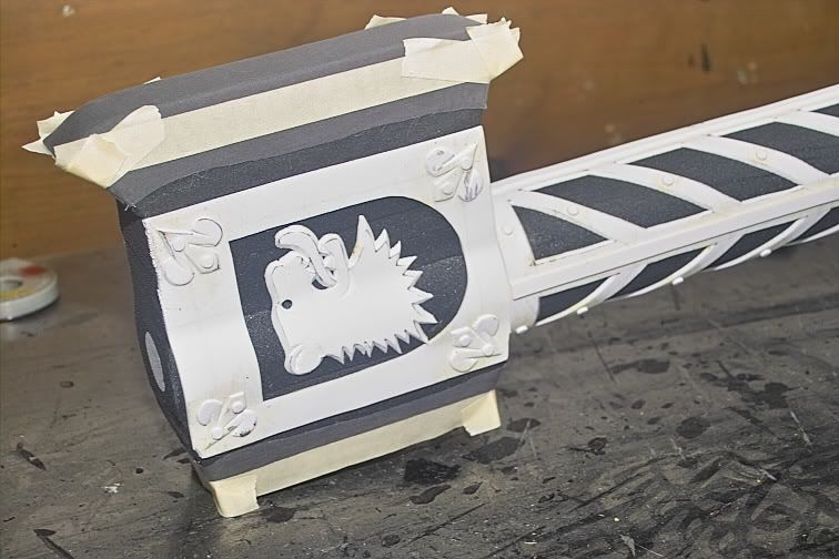

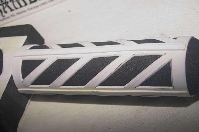

Cut out all of the little bits and pieces.  Reece's Pieces are awesome.  On most of the cuts I held the knife at an angle giving a nice bevel to the designs.

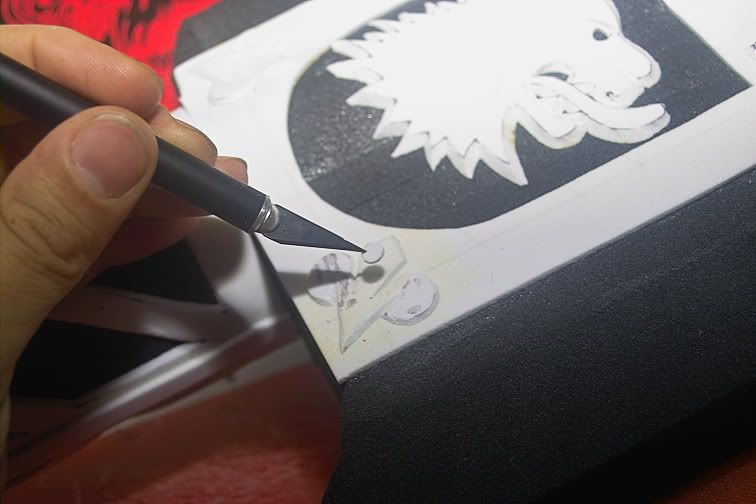

On this weapon there are multiple layers of decoration and I assembled as a first layer and a second layer
Brush a thin coat of dap over the entire weapon excluding the striking surfaces.  Rtuing to do precision gluing with this doesn't work too well.
It is easy to miss a spot.  Brush a thin layer of dap on the design cut outs.  FOLLOW THE DAMN DIRECTIONS ON THE CAN.  Let both surfaces get about as tacky as a postit note.
Also if the dap feels kinda cold, it ain't ready.
Once it is ready, slap on the first layer of stuff.
Do the same thing with the second and subsequent layers. You don't need to slop dap over the entire thing again.  You can be a little more precise with the glue.

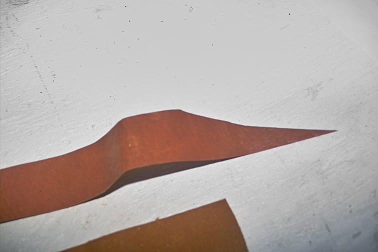

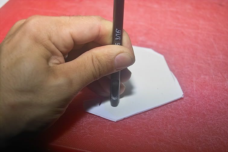

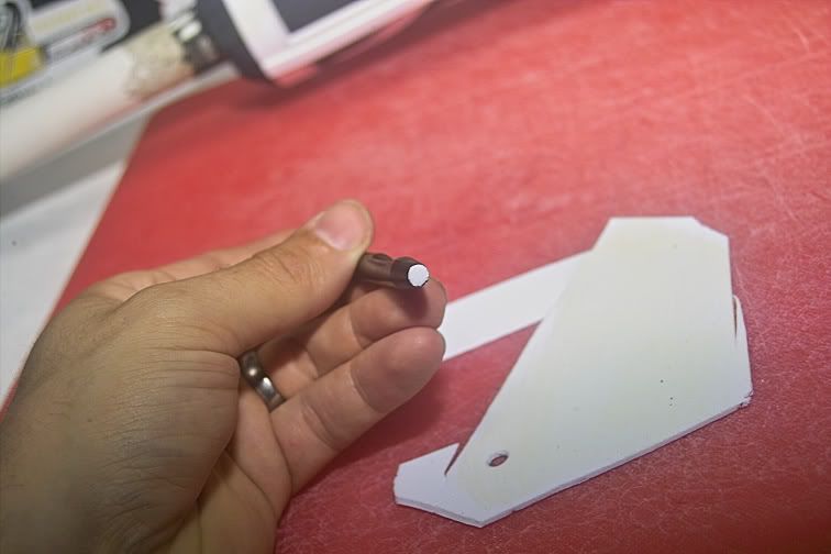

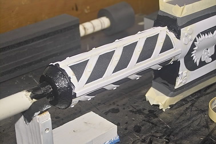

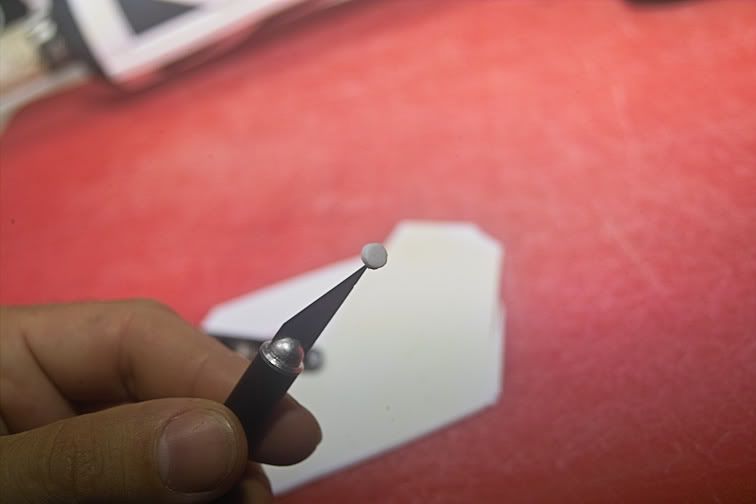

I find that the "rivets" and "nail heads" REALLY dress these things up.  To do these guys, paint spots of dap onto the weapon where the rivets will be.
Take a scrap of funfoam and give it a thin coat of dap on one side.  let them dry as you have with the rest.
Working with the dapped side UP press by hand the leather punch into the funfoam.  The cut out circle usually stays in the punch tube.  Shank it with a hobby knife.
Carefully place it on a glue spot and press it down.

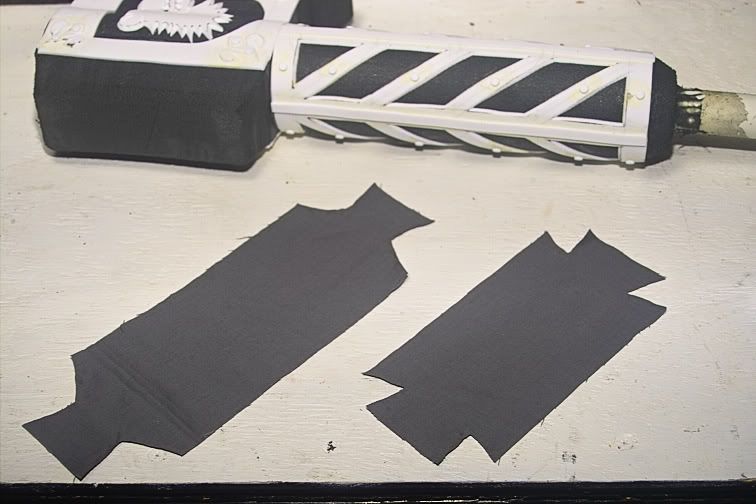

Now it's time to move onto putting on covers.

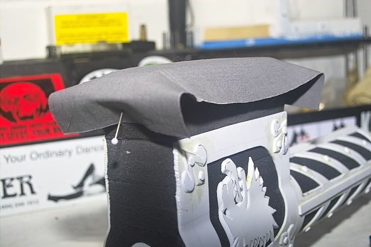

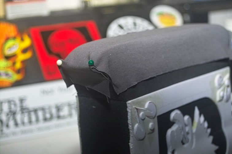

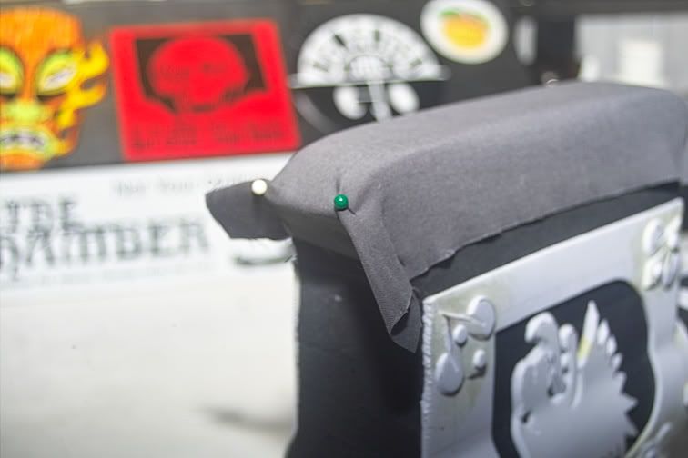

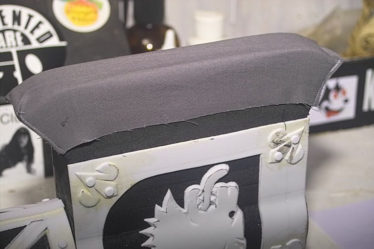

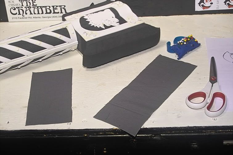

Cut out a piece of cloth the lenght and width of the striking surface + 2-3 inches.
Center it on the striking surface and pin it straight on to the foam.
Pull the corners tight and pin them together.
Trim off the excessand you'll have a rectangle with the corners knocked off.
Sew 'em up.  I typically run three lines of stitching over it to keep it from blowing out.
Put the sewn up cover on the blade INSIDE OUT.
Slap a coat of dap about 3/4" wide allong the edge of the cover.  Be extra careful not to go to heavy with the dap at this point as it can bleed through the fabric and make it all icky looking.
CAREFULLY pull of the cover and set it aside to let it dry.  Then put a coat of dap on the weapon where the edge of the cover will be.
Let em both dry to that postit note tackyness and put the cover on right side out.
Do this part really slow and careful like.  If you pull your cover down too tight, when it comes to slappin' on the dip the whole cover can come loose if the dap bond is weakened enough.

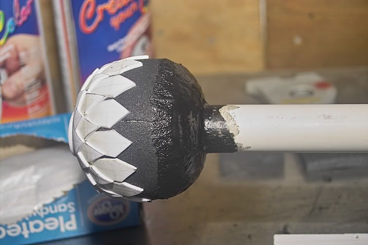

Before I go on with the how to, I need to give a couple of tips to working with pd.
Pd dries very quickly.

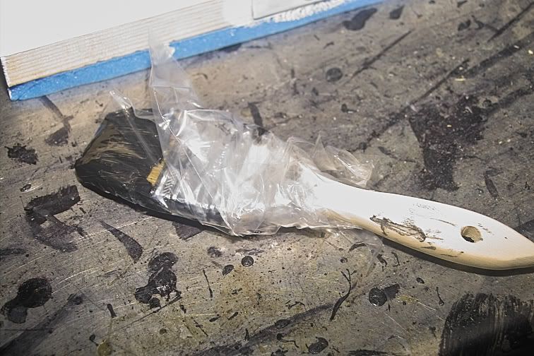

First to save money, those chip brushes cost all of $.80 but if you end up wasting ten of them building a couple of weapons, that's eight bucks in the trashcan.
In between coats of pd, I put the still wet brush in a plastic sandwich bag and wrap it on as tight as I can.
This keeps the brush useable for the length of the project.  I also do the same when applying dap.
Second pd is pretty thick stuff, and if you put it on overthickly it can clump up and obscure some of the cool detail work.
To avoid this I slop the dip on and then using the tip of the brush I will quickly run the brush in four directions over the dip; up, down, right, and left.
That seems to pretty well keep it from pooling in low areas and around nail heads.
This must be done quickly though, 'cause like I said it dries fast and if you over brush it too much you will leave brushstrokes all over the thing.

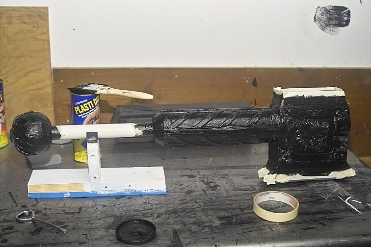

From here on, and I only want to write this once:
LET THE PLASTIDIP DRY TO TOUCH-DRY BETWEEN EACH COAT
What is touch dry?  If you touch it, you dont get a gloppy mess all over your hand.

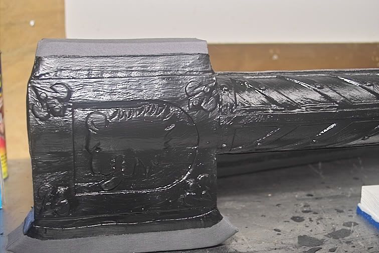

Use some masking tape to protect the cloth cover and make a nice clean line between the pd and the cover.
Put the edge of the tape about where the dap holding the cover on ends.
That's about 1/2" to 3/4" away from the edge of the cover.

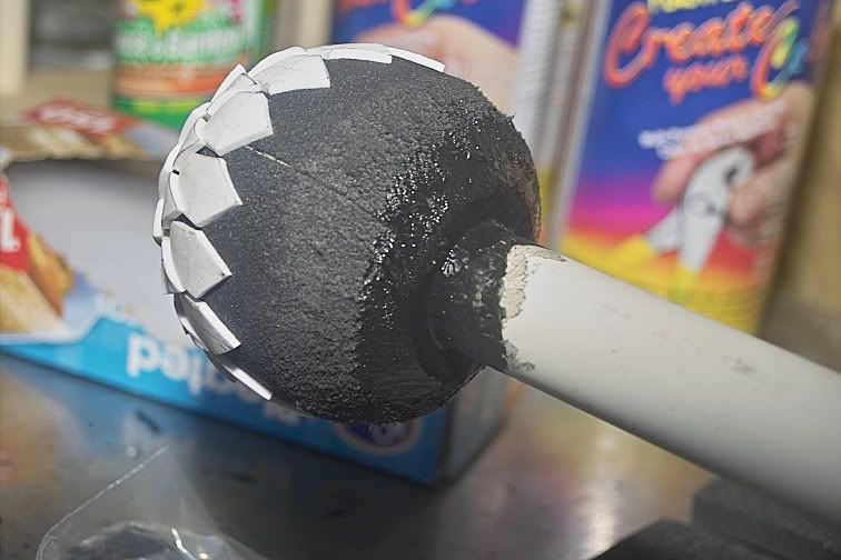

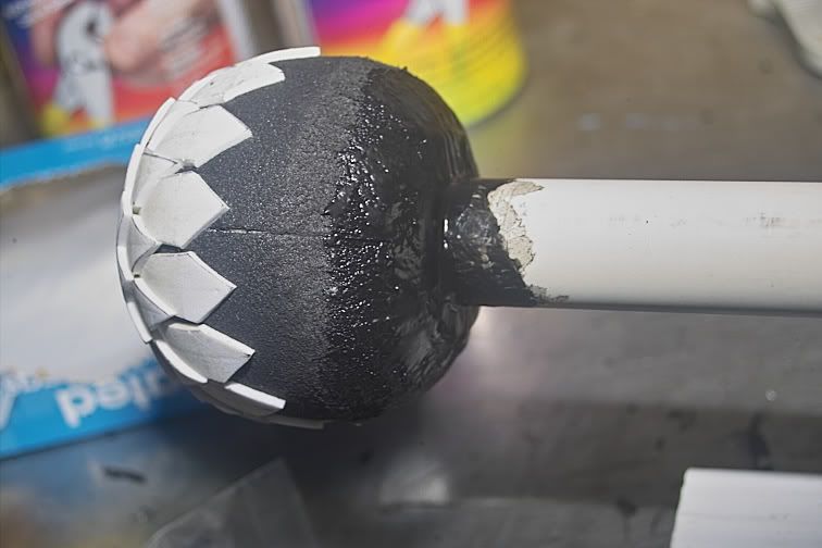

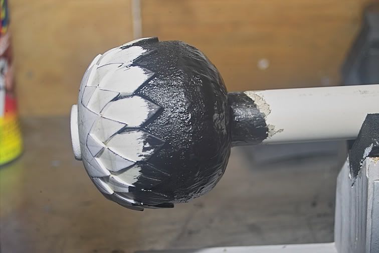

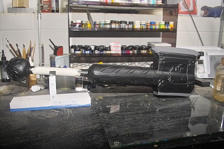

Start the applying the pd first around the high stress areas of the weapon.
Around the joint between the pommel and the handle, in the joint between an axe head and shaft.
This way plastidip can be used to add a bit of structural stability to these areas by increasing the pd thickness.
Typically on my weapons I will apply anywhere from 8 to 12 coats of pd to these areas.
Begin with a 3/4" band around the pommel joint.
Then go on to a 1 1/2" band.
Keep layering and increasing the area of coverage until you have coated about two thirds of the pommel/underside of axe blade.
Once you have done the high stress areas, slap a coat over the whole thing.
It will look awful and uneven when it is wet, especially on the first coat.
Don't worry, it self levels.
As soon as you are done applying the 1st coat, very carefully remove the tape from the cover.  Pulling the tape off when the pd is wet is one hell of a lot easier than once it has dried.  Trust me I know.
Apply a total of 3-4 complete coats of plastidip.
If you are not going to paint and clear dip it, give it one more coat.

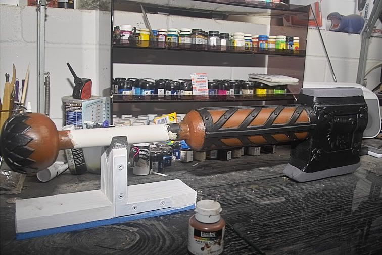

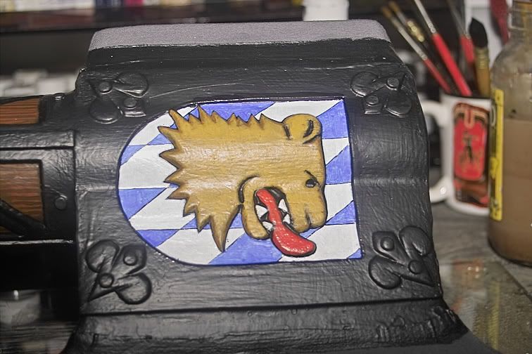

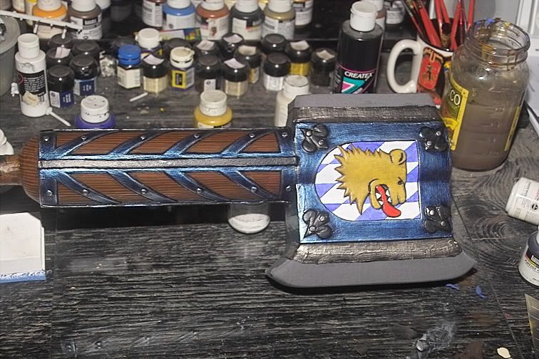

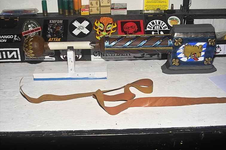

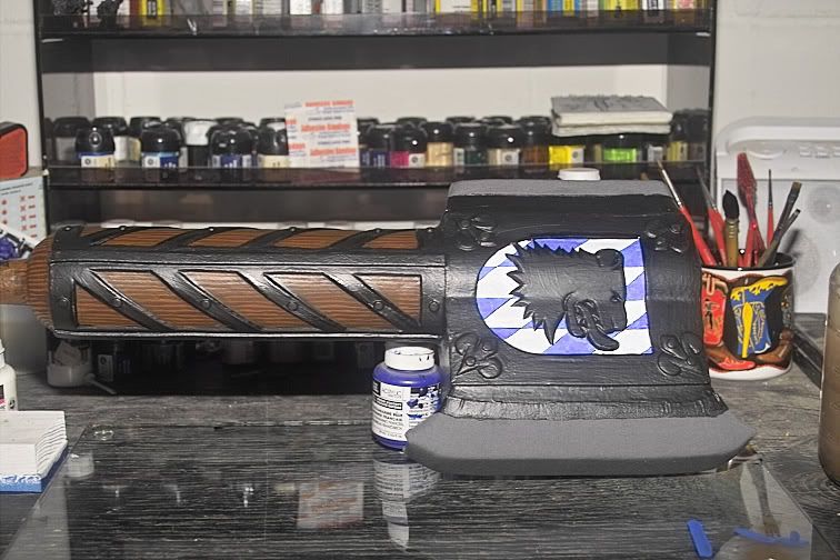

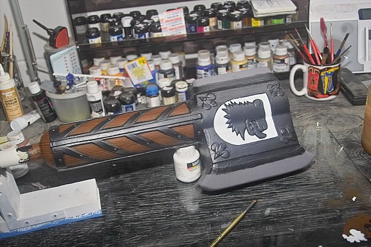

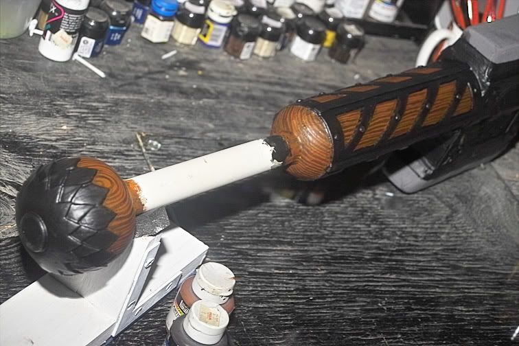

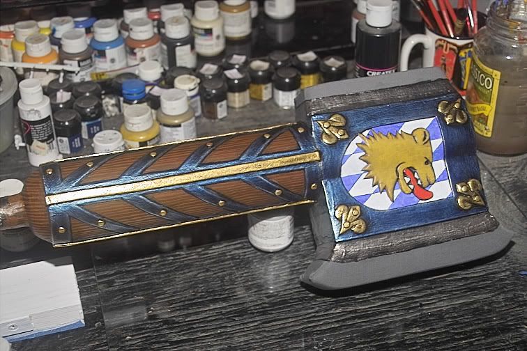

The painting is pretty straight forward.
Slap paint on weapon.

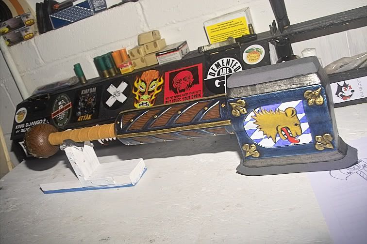

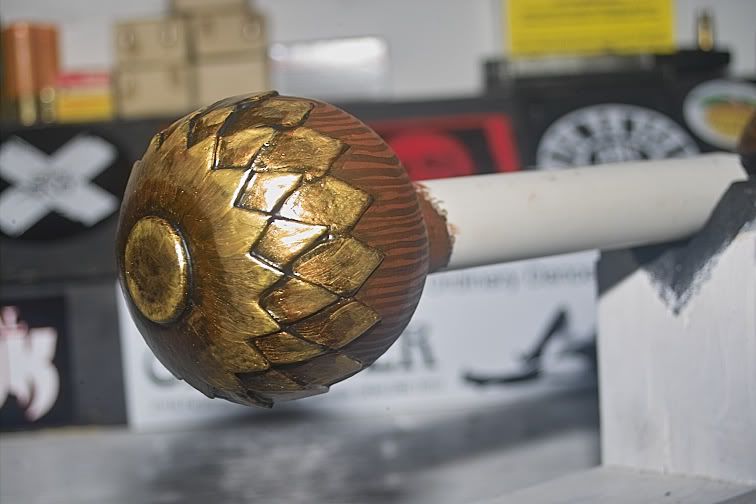

Wood grain worked fantasticly on that mace I did earlier, so the notion of the wood grain peeking out of the haft decoration seemed cool.
I decided to put the Bavarian blue and white behind the lion head 'cause I think Bavaria is a cool place.
For the decorative "metal" work, old Colt bone charcoal blueing and gold complemented the Bavarian lion thingo pretty ok.
Finish it with one coat of clear pd clear spray varnish.
Wrap up the handle any way you want.  I chose to use some rough out pig lining leather.
Then you are all done!
And you have a fist full of awesome.

How much additional weight does your PD design use?
Could you give an estimate for like a four inch tall section, and as wide around a blue sword?

I find that the pd weapons turn out lighter rather than heavier.
If anything I've had to find ways to add weight.
Guess I'll have to break out the scale and figure out how much weight it adds.
Yeah, it's significantly lighter than any tape or cloth cover, even with the extra foam bits. I usually have to weight stuff to get it up there into legal territory as well.

Looking at the pics, I really like that foam, THAT is EVA? I have seen a different type of EVA then, now I am confused. That stuff looks nice and solid, drool...  I am emailing you tonight.
Yeah, that is the actual EVA brand from McMaster, not a crosslinked PE that is almost exactly the same which you can get from foambymail.

Wynar laddie, that is one beeyoootiful axe there laddie, I would be proud to take a hit from such a lovely work of art...
Think about this...The Scottish Highlanders were a very poor people, no armor to speak of, only the most basic of weapons, and still the English, whom had one of the most powerful armies of the time, considered them to be a huge threat!  Hmmmmm

It just looks too fancy to use. I would use this more for ceremonial, competition prize, or as a gift.
It is an amazing looking weapon
I might make 'em pretty, but first and foremost I make 'em for fighting.  Like Lizard said the pd can take some abuse.
I beat the hell out of my zweihander. At two different points during Rag is was the subject of a tug-of-war, involving me and a grappler, and I truly believe that the thick PD I put on the quillions are what kept them from being tugged off. It looks nice, AND is tougher than ****. Seriously, that stuff is insanely tough. A sharp knife can cut right through it, but who uses a sharp knife on the Dag field.
